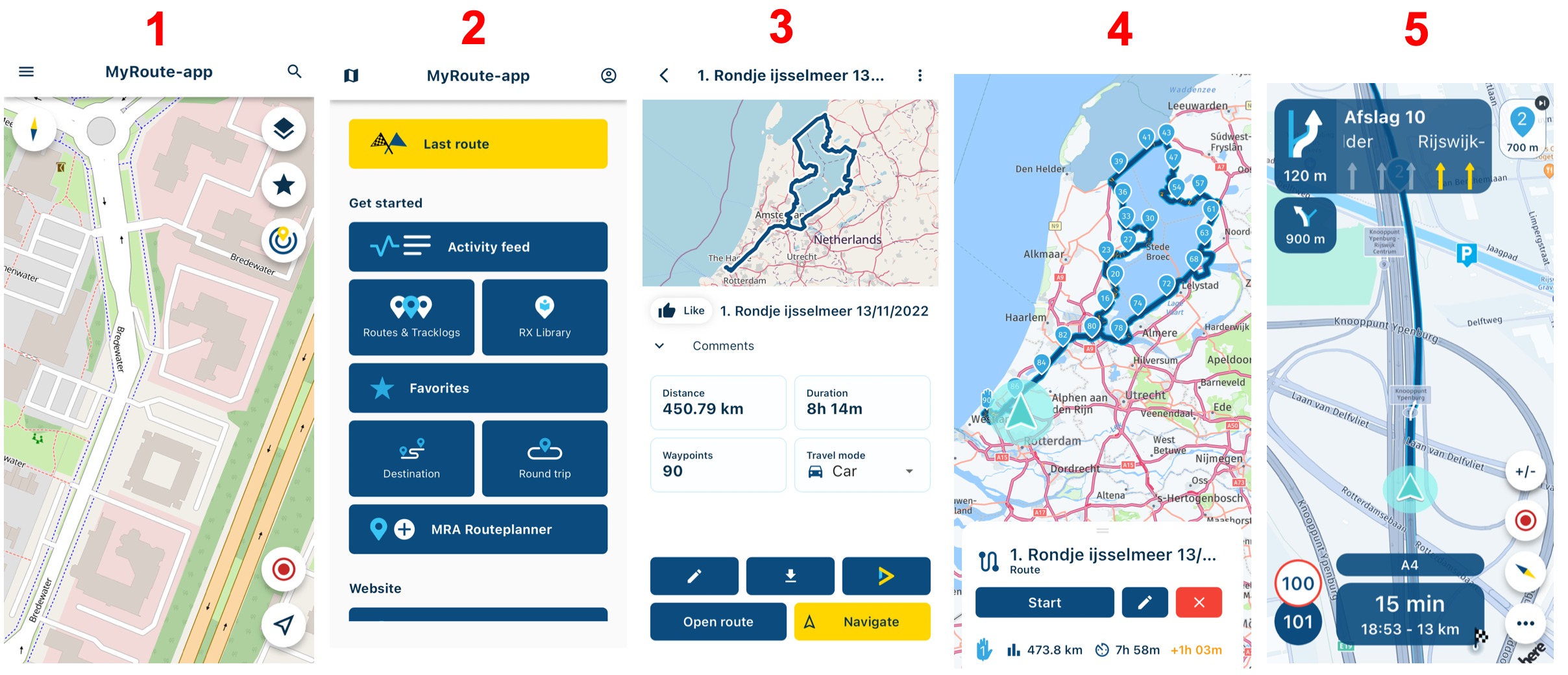

From the app
See here which screens you encounter when you start a route in the app for navigation. The manual will sometimes refer back to these screens.
- Open the app and click on Routes & Tracklogs;
- Select the desired route and click on Navigate;
- Adjust your preference on the navigation home screen if necessary;
- The navigation screen.

Click on the button at the top right of screen 1 to go to the app settings. Here you will find the offline maps.

Click on the button at the top right of screen 1 to go to the app settings. Here you will also find the navigation settings. During navigation, you can also open the navigation settings by clicking on the three dots at the bottom right (screen 4).

Screen 3 is what you see when you start navigation. Screen 4 is the navigation screen.
- When starting navigation, you can choose whether the route should start at the starting point or at the nearest waypoint;
- When starting, you can also start from a specific waypoint by pressing it on the map for a long time;
- When navigating routes as tracks, you can start the route from a specific point on the route by holding the route line down for a long time;
- When navigating, you can skip a waypoint by clicking on the next waypoint (top right button - screen 4). When pressing briefly, you must confirm the choice; when pressed for a long time, it is skipped immediately;
- You can also skip multiple waypoints by going to the list of waypoints (three dots at the bottom right - screen 4) and clicking on the waypoint where the navigation should go directly;
- Just like when starting up, you can also hold down the waypoint/point on the route line during navigation on the map to navigate directly there.
